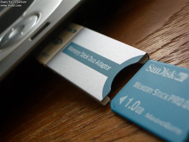

actually, i just updated my firmware to r1n035 and i've been having some significant problems. I know there's a bug that corrupts the file system on some memory sticks, i followed the instructions, and even tried to reflash my phone. But the problem's still there. Whenever I create new folders, I get a lot of ascii characters and the folder itself is absurdly large (like 100 gigs). It also has problems copying mp3's. Anyone else having this problem after flashing?

Yeah I had that prob. I formatted my memory stick using FAT and all was gone! No 100gig folders! lol But I kept the folder layout cos I wanted it to be the same.. cos when you format, it deletes everything.

U can get around the problem with stickin the card into a cardreader, making folders, draging files there. Itīs also way faster than copying from the computer through the cable.
