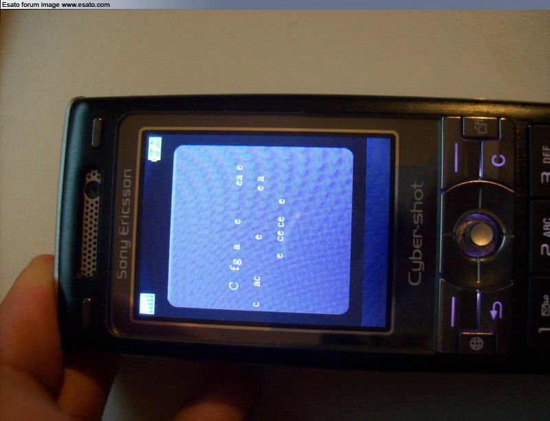

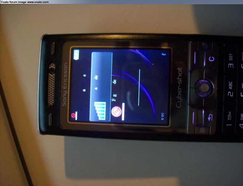

Hi, i dont know what it is that doomed my k800i but here are some pictures.. mayb someone knows what this is

Posted: 2008-12-16 20:57
Resh
It seems like wrong or missing CDA (customization file)...
Did you finalize flash...?
