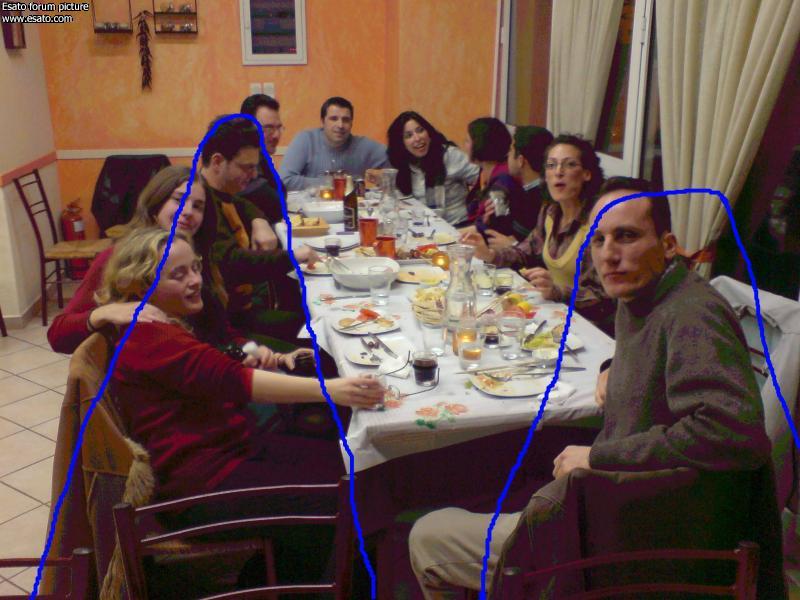

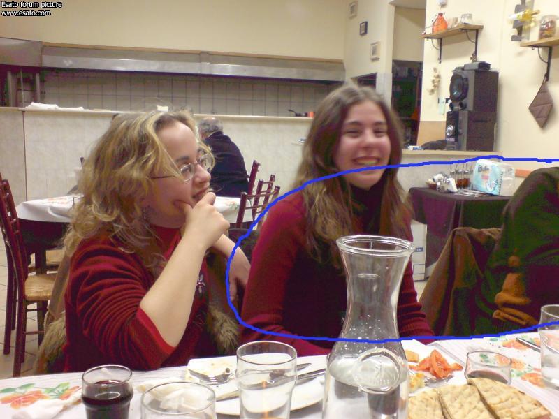

I uploaded a couple of photos to show you what I mean. Look carefully at the areas inside the blue lines that I've drawn. Does anyone have the same problem?
Anyway, I'll propably take the phone to a service center, cause that's not what I paid for!!!
[ This Message was edited by: Sky Hi on 2008-01-28 17:11 ]

i have never seen that before i think you have a faulty cam module yes take it to a service centre and get the camera module replaced, i use a k800i with k810i firmware and i have never had any pics like that before.

Looks like "posterization" effect. are you applied any in-camera effect?
also providing EXIF maybe helpful.

And no those pics you uploaded look weird, that colordistortion looks wrong. If i were you i would send it to service.
But one should be prepared that "darker indoor" pics can have some noise in them

i agree as well. it looks like the solarize effect to me.

If he had solarize effect ON, there should be more distortions dont you think?
Try taking some pics its pretty obvious when you have it ON.

I should mention again that I DIDN'T have that problem with my k800, which took almost perfect indoor pics. Of course I don't have any effect applied (it would affect the whole pic, don't you think so?), and for sure I DON'T want to use a modded driver and mess up my phone while loosing my warranty at the same time.
