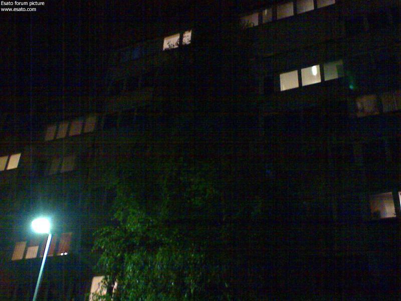

I just went out of building and used the oportunity to connect to home w-lan:) Here is a picture (too dark sory).
