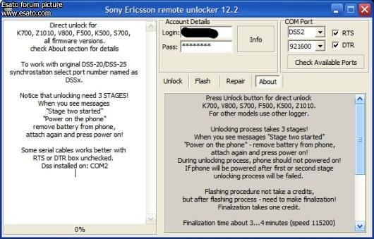

I'll clic on Flash,he say me to "Power On the phone"....and nothing appends about 5minutes....
Please Help.....What did i do???I'm tired....

I found everytime you want to do a read cid or a flash, i had to remove the phone from the dss, remove battery, insert battery, place phone in cradle then at the "Power on the phone!" prompt, press AND HOLD the power button. Once the flash or cid read gets going you can let go of the phones power button. I also had to flash a few times before it worked, oddly enough it worked once i set the baud rate to max (921600 in Davinci and 128000 in Device manager)
Updated to R2AE today and very chuffed. SEUS now says "Your device is already up to date". We'll see what happens when the next update is released on SEUS.
