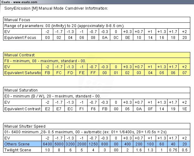

the development plan for next version v2.37...
anyone have best idea or set for shutter speed??
(Shutter speed are modify complete on my snapshots version 0005)
i want change "CONTRAST" to "Effects & Color Correction"
replaced Effects menu
Auto
Focus
Saturation
Shutter Speed
Effects & Color Correction (-= Effect & +=Color Correction)
are you think ???
if you want to beta test... this my camdriver development snapshots
[M] Manual Mode Camdriver Snapshots
[ This Message was edited by: SEC5100 on 2009-11-06 07:02 ]
