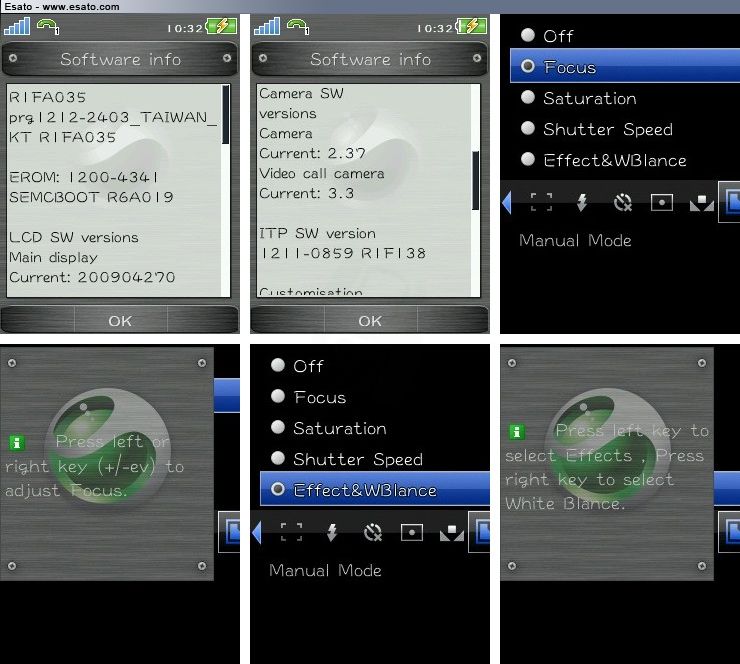

Software: [M] Manual Mode
Version: 2.37
Apply to: Sony Ericsson C510
Date: 2009/12/22
sample:
Howto:
Manual Focus:
Set camera menu [FOCUS] to [INFINITE],
Go to [Manual Mode] in camera menu Select [Focus].
Use right or left key (+/-ev) to change lens position.
Manual Shutter Speed
If you want 1s or 2s speed, camera menu [FOCUS] plese set to [INFINITE]
or change scene to twilight or landscape..

Sorry I didn't post the pics as promised. As of now i'm taking pics and so far i've tried manual focus and manual saturation.

It's given very good results during the day. But there's something that annoys me. If I set the manual focus to +2.0, take the pic and then go back to the view finder the focus goes back to 0.0. Althoug I just change the EV and it fixes again.
Another thing is: where are the effects?
And finally, did you change something today to the camdriver?
This was my feedback

1. If I set the manual focus to +2.0, take the pic and then go back to the view finder the focus goes back to 0.0. Althoug I just change the EV and it fixes again.
2. where are the effects?
3. did you change something today to the camdriver?
1: What is your Scenes?
When I use manual focus, I am goto Focus and set Infinite, and take pic go back view finder, focus is no goes back..
2: field not enough, I am change the effects to shutter speed,
if want effects, must delete contrast or saturation , you think contrast and saturation which one is important?
3: yes, the small bug fixed.. you can update driver again..

My scene Is set to auto. I think you are confused with Focus. Saturation is more important for me. Let's what other users say about it. Another thing, I cannot try the new camdriver as I don't have a computer until monday.

change the scene to twilight , or goto [ menu ] set the [ Focus ] to [ Infinite ] for use Manual focus ...

I've just set the focus to infinity and it works fine.
