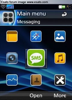

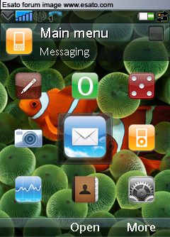

Not sure if this had been posted earlier but click here to download the "iPhone black" SIS installer icon pack for the G900 (UK English only).
Screenshots:
Cheers!

julyjohn1911
Joined: Nov 13, 2008
Posted: 2008-11-17 12:07
Thanks! i have changed the icon successfully...
here is the screenshoot:
But, the camera icon doesn't change at all, anyone can help me?
