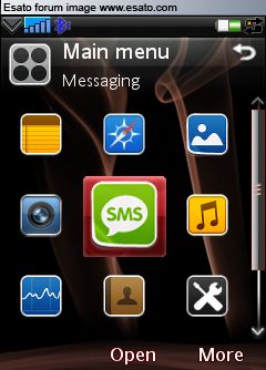

here's my g900 with all menu icons changed...
[ This Message was edited by: kit513 on 2008-10-14 14:34 ] |
madhosh121 Joined: Oct 13, 2008 Posts: 3 PM |
yes tht's the look! with all...but 2 of mine arnt...

kit513 Joined: Mar 27, 2006 Posts: 42 PM |
any advice kit?
are u using UK englsih or US english?
to change media icon: thanks to DJ_Ali_k of Persian forums
You must rename C:/resource/apps/mediaPlayerappicon.mbm
TO:
You must rename C:/resource/apps/mediaCenterappicon.mbm
And too
C:/resource/apps/mediaplayer_loc.RCS
TO:
C:/resource/apps/mediacenter_loc.RCS
to change your media center icon
i use UK english... i'll send you the and camera icon... try it...
