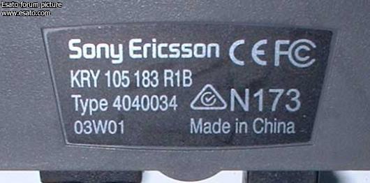

I've got a nasty feeling we've got DSS-20's that aren't really DSS-20's. They're DCU-11's in disguise.
According to the SE Update Service "not all SyncStations supports this service. The label on the bottom of your SyncStation should say DSS-20 or DSS-25."
Mine doesn't actually say DSS-20 anywhere on it.
I think we've been supplied with early SyncStations that don't have the required connections. It's probably why they're so cheap on eBay.
Wonder how friendly my eBay seller will be about getting a refund or exchange?
Anyway, don't buy a DSS-20 from 5tech*co*uk in the meantime. |
tom78999 Joined: Sep 16, 2004 Posts: 61 From: Wirral, Merseyside, UK PM |
Yeah, just finished editing my post. If it doesn't say DSS-20 or DSS-25 on the base then you can't use it to do the online upgrade, no matter what other numbers are on the base. I'm not sure what you could do, other than try and get hold of a proper one. Mine is a real DSS-20 though, as its printed on the base - its very confusing that SE chose to do this as the only visible difference is a small code on the bottom.

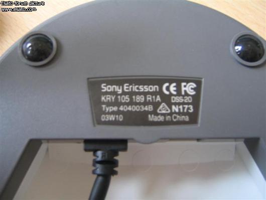

Jools Joined: May 21, 2003 Posts: > 500 PM |
arthurfuxake:
What exactly does yours say on the base? |
sorry dahlborg, we must be blind
Nokia 3210 -> Nokia 3510i -> SonyEricsson K700i |
arthurfuxake Joined: Sep 18, 2004 Posts: 5 PM |
On 2004-09-18 14:31:10, JoolsG3 wrote:
arthurfuxake:
Sony Ericsson CE FC
KRY 105 189 R1A DSS-20
Type 4040034B N173
03W10 Made in China
Edit - Picture here
[ This Message was edited by: arthurfuxake on 2004-09-18 13:45 ] |
This is what the base of mine looks like (the non-working one):
Wow, I've been lucky twice in one day !...
First my DSS-20 arrived in the post then morning from 5tech*co*uk via Ebay and it's a proper DSS-20, where as others seem to have got what looks like a DSS-20 but actually isn't, from the same supplier.
Then I managed to successfully upgrade my O2 supplied K700i where as others with O2 phones can't!
