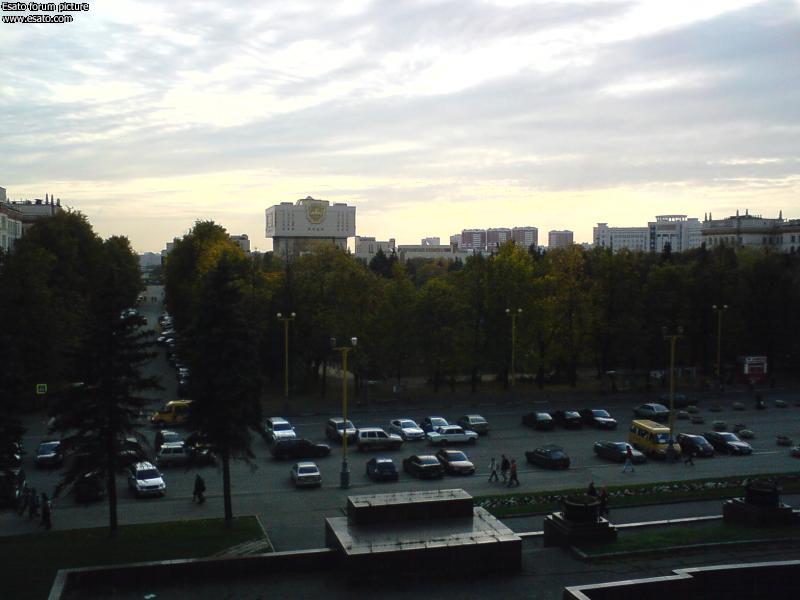

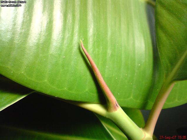

Photo comparison (visual,not math "blablabla") 2.4 and 2.32 i ve spoken several post ago.
So,3 first-hand pictures(there was no election of the best of several)pictures were taken: View,Macro,Lowlight place. What is better - ups to you.
2.4 View:
2.32 View:
Almost the same but as for Me, sign on far building is clearer in 2.32 and red car in 1-st line is sharper.
2.4 Macro:
2.32 Macro:
No comments.
