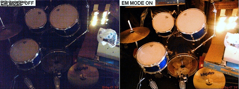

release b/ 21 09 2007
1. VR is set to average 24 fps instead of 10 fps (up to +30fps !)
2. Enhanced night mode (EM) from Raiderski
note : you have to be in "dark portrait" mode in order to use EM,
and be warned that it is still a bit unstable !
(fine qual and sharpening from previous version REMOVED)
