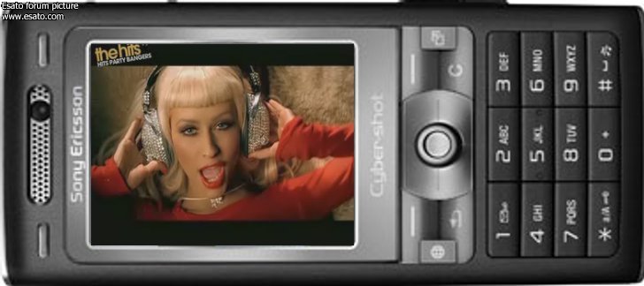

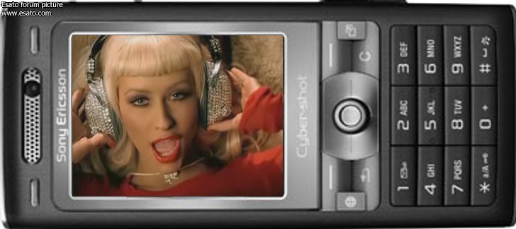

Back to manual cropping here are a couple of pics actually converted using M3 the cut and pasted onto a K800i photo to explain
The best built in crop possible to remove black bars using M3
Manually cropped using Virtualdubmod then encoded using M3
Hope this helps!
