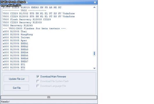

You phone will be CID29 yes. But most server software can flash any CID flashes to any phone - thats what TMS and setool do. Can you tell me what recovery files there are? If CID36 then try to flash with that. |

i'll take a screenshot of everything as soon as it finishes this time.

i just tried to flash to a voda setting old flash file and it froze on the 3rd block of the FS.
Please see screenshot.

gbrooks3 Joined: Jun 02, 2003 Posts: > 500 From: OTP RED CID36 PM, WWW
hmm, thats interesting, man davinci sucks. As the flash failed i bet you have erom erased again. So lets try this again:
1. flash recovery file the R1D003 one skip finalization
2. Flash main and fs R1D003 files with finalization
battery should hold out for a few more goes. - If not you will have to charge it in another phone or get a new one i guess....... |
