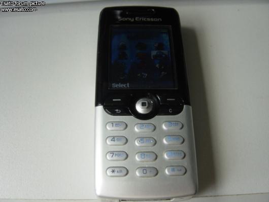

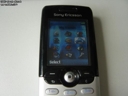

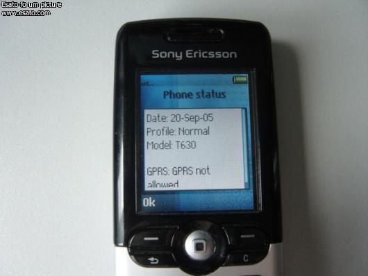

The T610/T630 hybrid arrived today!
As requested, here are some pictures:
It has T630 firmware and a T630 LCD, but the actual PCB and obviously casing are T610. Works really well!

Cool. Your T625 looks good
IMO the good looks of the T610 with the better screen of the T630 + My Friends. Excellent!
