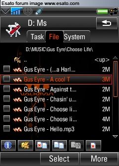

I associated the 'sound files' with the Walkman3 hacked programme...
All the mp3 files show a little icon next to them in SMP file manger - nice
How cool is this???
Nice job CPS...
Select a music file from from file section of SMP
'Information' box pops up with red warning triangle saying 'Not supported' option soft key 'continue'
Press 'continue' soft key message 'dump file created' - Application closed box appears with message:

@arvinlad: You assigned the wrong application to your MP3 files. WALKMAN is not a true viewer, because it can only play files chosen from its own file selector, but can not play files passed from a file manager. Therefore you get the error messages. The true viewer for MP3 files is called WALKMAN Viewer, so you need to associate that one.

Aaahhh... I see... With Walkman app you need to get it to search the phone for files and select from that list!
Is there a 'WALKMAN viewer'? - I really like having the little icons next to my mp3 files - sad I know but that's the way we phone geeks are
Thanks...

Posted: 2008-10-30 11:14
Yes, exactly. There are many apps that look like viewers but they are not. An example is X-plore, which can nicely display RAR and binary files, but only from within itself, and not from the "external world".
Yes, on W950 and W960. However, it is apparently not contained in the currently available installable "ports" of Walkman.
The Walkman viewer has a musical note icon, not the one you like. So, in addition to including the viewer in the installable Walkman "port", you also need that the app icon is replaced.
