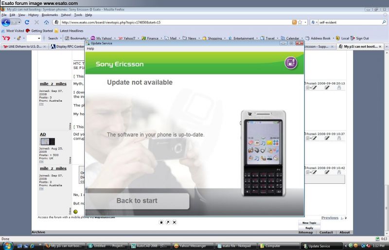

mile_z_miles Joined: Sep 07, 2008 Posts: 7 From: Australia PM |
On 2008-09-09 11:42:40, mile_z_miles wrote:
On 2008-09-09 11:37:48, AD wrote:
Did you not have the 'continue anyway' option in SEUS? This will make it reflash your phone, and hopefully replace any corrupt files.
No, I didn't get that option.
But now that you've mentioned it, I will try again just to make sure.
Yup, I'm sure there is no "continue anyway" option. I took a screen shot of the last page.
AD Joined: Aug 25, 2005 Posts: > 500 From: UK PM |
Well, it seems that SEUS works in mysterious ways...It does look as if your only options are to use XS++ to switch to GW1, or to take it to be reflashed at one of SE's service centres as they have access to the EMMA server which is denied to us mere mortals. |
