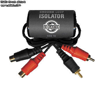

I have come across the ground loop problem before and like the 2 speaker issue there is an inexpensive gadget to deal with it. My old boss used to refer to them a 'chokes' dunno why, I knew them as ignition supressor's.
This example has RCA connectors but not all supressor's do.
Does the back of your Headunit look like this? Particulaly the 10 pin (unused) socket at the top?

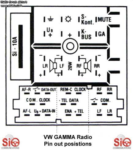

But I did find one on my own - here are the connectors on the back of my stereo.
The 8 pins at the top connector are power, ground, etc., as well as the telephone mute pin. The 8 pins in the middle connector are the speaker outputs. The bottom is a 3-part connector. The one all the way to the left is for the factory CD player or changer. The one all the way to the right are IIRC line level outputs for an external amplifier. Most of the pins in the middle are for a much fancier instrument panel than I have in my car, one that repeats the radio display info. The one I currently use is a single wire, "REM-C," for the steering wheel controls. Note the "- TEL" and "+ TEL" pins, those take a speaker-level (yes, I'm sure) input for mono sound from a handsfree kit.

Good news! You can connect straight from the HCA-60 to to the Headunit without needing the HCE-26.
Just take the speaker that comes with the carkit and cut the cable at the speaker end. Plug the connector into the HCA-60 control box and attach suitable connectors to the +ve and -ve speaker wires at the other end.
Then plug the connectors into the terminals marked -TEL and +TEL and your done. Sound from your carkit will enter the Headunit and be played by the speakers.

By connecting the speaker output to the TEL inputs you'll avoid any external amp problems.

One problem - that will only give me Mono sound, even when stereo music is playing from the phone
Otherwise, you are correct. The "TEL" +/- inputs want a speaker-level, not line-level, mono input for phone audio. This cause no problems for the factory amp.

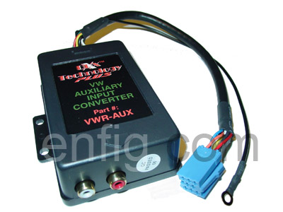

I bought an MMC-60 and an AUX-in converter for my stock radio's CD changer port. I'll test this out with my Jabra SP500 speakerphone, the only handsfree "kit" I have right now. Let's see if the two play nice together. This thread tells me they won't, but an e-mail response from says otherwise. At least I'll get the music off the phone, in stereo, in all 4 speakers, with no ground loop, this way.

Not seen that device before, very cool.
Hlcn Twst Joined: Jul 27, 2006 Posts: > 500 From: Purgatory, Utah, USA PM, WWW
There are quite a few of them out for all makes and models from several manufacturers: PIE (VW's OEM supplier of iPod interfaces IIRC), PAC, USA-Spec, Blitzsafe, off the top of my head.

1. mmc-60 to a converter like the one you show in a photo earlier that allows me to use my CDchanger input
Pros: should sound awesome
Cons: cost of both pieces of hardware(converter is like 65 for my ride). No battery charge for my w810
