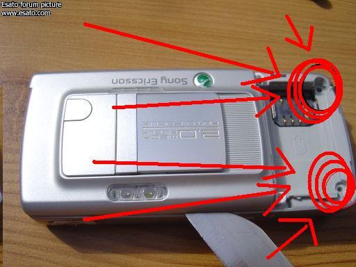

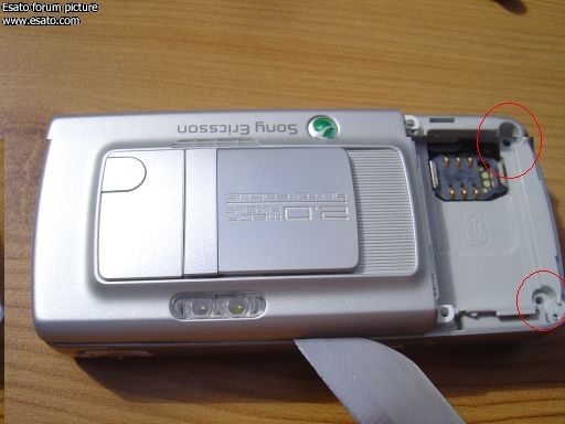

Is it necesary to quit this to remove the front cover? I cant find that screwdriver.
Sammy_boy
C510 Black
Joined: Mar 31, 2004
Posted: 2006-07-17 19:24
You can do it without removing the back cover, just the front one
rrojas260
Joined: Dec 13, 2003
From: Valencia, Venezuela
Posted: 2006-07-17 22:34
I mean, do I have to remove this screws?

Yes, those need to be removed as they hold the front cover in place

I do not have access to a torx screwdriver, so any other way to remove them?
whistla
Joined: Aug 22, 2005
Posted: 2006-07-17 22:51
No, not really otherwise you will mess up the screw head. Cant you just buy a T6 from ebay, most people will ship worldwide if you ask?

find a blade screwdriver that is the width of the torx head inside star point to point (if you get my drift). I've used jewellers screwdrivers of the right size on torx heads before. Just be careful not to strip the head.
