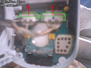

I'm guessing lift up the hinge-like clip on the top? Hard to tell from those pics

On 2006-02-21 07:54:45, saqibq wrote:
** i did.. i gave it to SE authorised dealer.. they wont take it.. They say liquid damage repairing is not under policy.. they wont repair the fone weather its under warranty or not.. thats y i want to repair myself cuz i know it can b repaired..
It's true, SE don't touch liquid damaged equipment. In the SE engineer's troubleshooting guide for mobile repairs, it says liquid damaged equipment must be replaced with new components (obvious, when you think about it). So even if they only needed to replace the board, it's not an economical repair. They won't touch it because they can't gaurantee the work.
Regarding the cables, it's quite easy to remove them, they have a latch that when pushed forward allows the cables to be easily extracted from the clip. Installation is a reversal of the removal procedure.
As long as you are careful and don't use undue force you won't break anything (standard disclaimer yada yada yada)

@ max_wedge
hey can u explain it once more.. how to remove the cables.. r u sure the technique is for the w550i..

those are the blurriest pics ever! did u take them while the phone was still in the glass of milk?!
max_wedge
Xperia Neo Black
Joined: Aug 29, 2004
From: Australia
Posted: 2006-02-21 17:09
there is a standard way of connecting such cabling. There is a part of the clip that slides away from the connector so that the cable can be removed. When the part is in place, it locks the cable in place.
See the green outlined part below, the red arrows are the direction you should gently move the green outlined part so that you can remove the cables. However the picture is not very clear, so I am partly guessing. The green outlined part may lift up rather than slide.

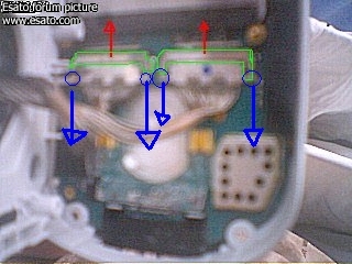

max_wedge
Xperia Neo Black
From: Australia
Posted: 2006-02-23 00:44
okay I had another look, and the green part looks fixed, in which case try pushing the tabs circled in blue downwards (direction of blue arrows), then you should be able to pull the cable out.
*Jojo*
Joined: Oct 15, 2003
Posted: 2006-02-23 00:56
@max - Nice demo mate ! I'm learning a LOT from this thread
