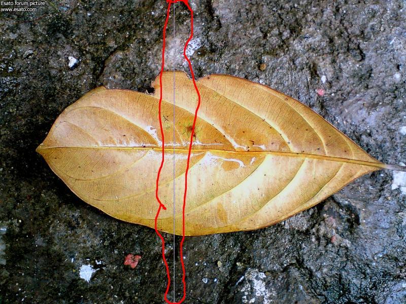

guys one more of photo just 2 explain my problem ....
the clarity is good ..... but that white line :-(:-(:-(
Deep trouble now ......

i have the same problem an it begin when i put the new camdriver

@ elviper
so it must be due to the cam driver .... thank god ....
now we must find back the orginal w610i stock driver and install it .....
but the problem is where will we get it ?????:-(

chriss the orginal cam driver has the same line in photos ......
So surely a harware damage

Hi guys
first of all A BIG SORRY TO CHRISS for the above posts ........
Well I just reverted my phone back to the orginal condition as it was before
that is now I have K550i FS + MAIN
!!!!!!!!!!!!! And still in the photos the solid white line is coming !!!!!!!!!!!!!
So this means that my camera module has been damaged .....
It has nothing to do with ur modded drivers ...... THOSE MODDED DRIVERS ARE WORKING OK AND GOT NO ADVERSE EFFECTS ....
It was only a co-incidence that the lines started appearing the photos only after using the modded drivers !!!!!!!!
So that was a misleading info..
Sorry guys .......
Here's the conclusion ......
My camera module has been damaged :-(:-(:-(:-(:-(:-(:-(:-(
So bad ...... now all I need to do is to take it to a sony service centre !!!!!
