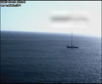

A new problem
If I convert a file with the GPU dx9 filter I get in the upper right corner some lines, looks like artefacts or something like that. I have a X850XT-PE gfx.
Is the quality better with the GPU Filtering ?

masterv, there's a bug in the GPU filter for ATi cards, a fixed version will be in the next version of M3 though.
