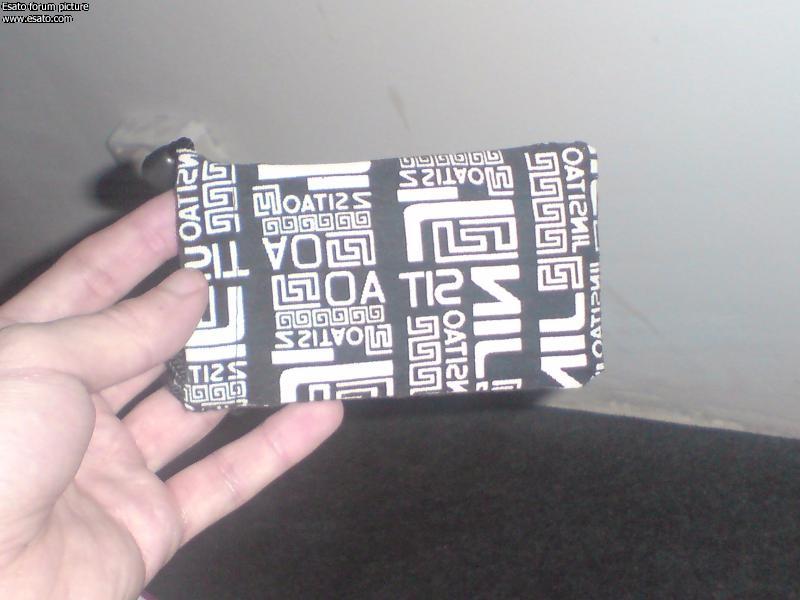

@ Scorchio
On my K850, I have problem with dust only under glass lens cover. All other parts of the phone are clean. I keep my phone alone in pocket...and there's no dust.
Anyway, i've just recently bought a little some sort of bag (see in picture) for mobile phones, and my K850 fits there prefectly.

Posted: 2008-01-28 20:46
Did you put the lens cover back on or didn't it stick back once you had taken it off?
Does it get annoying having to take it out the bag thing all the time?
