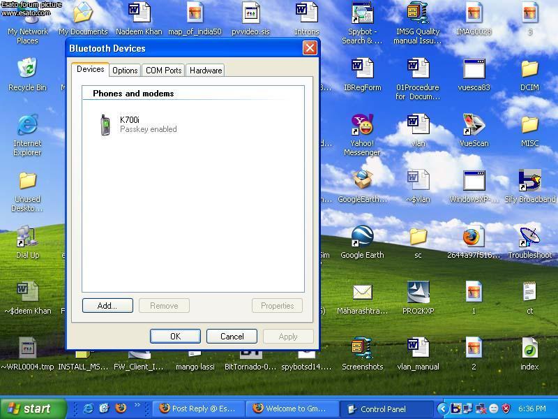

So you have not assigned a comport. Do this:
1) Insert your dongle in the usb port.
2) Go to Control Panel then Bluetooth devices.
3) If you have paired your phone then your phone will be shown. Like this in my case its a k700.
4) Select the tab COM Ports.
5) Turn on bluetooth on your phone.
6) Click add and then select Outgoing(Computer initiates connection).
7) Click browse that will search for device that wants to use com port.
It will find your phone.
9) Click OK.
10) It will assign a comport to your phone.
When using MPE select that comport and enjoy.
If any probs inform me.

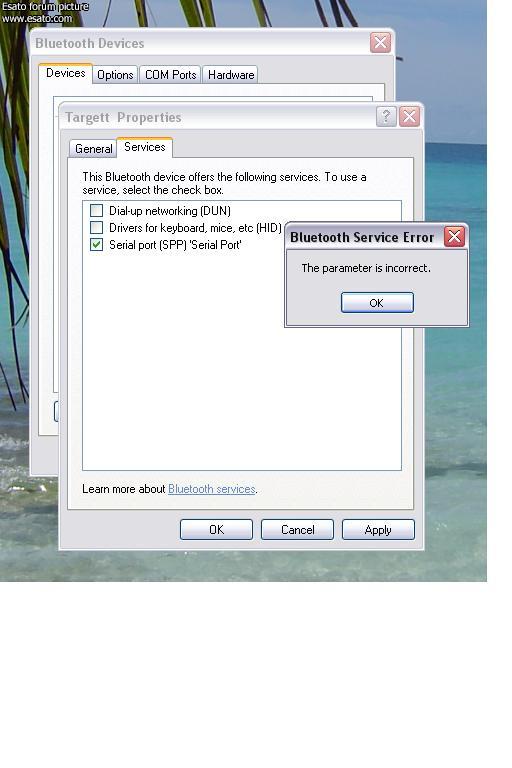

Posted: 2005-12-19 17:54
indiannawaf wrote:
If step 7 doesnt work:
Instead of going to tab COM ports, select your device and click properties. Click Services. Check the Serial port check box and click apply. It will assign a COM port. When doing this your system will show found new hardware ballon saying serial port over bluetooth.
Tried it exactly as you said, but it didn't work for me!? see pic for what happens when i click on 'apply'...
Any ideas?

Targett
C902 Black
Joined: Sep 27, 2005
Posts: 120
From: Sandy Beds
Posted: 2005-12-20 19:50
indiannawaf wrote:
Do you have a bluetooth dongle or a cable?
BlueTooth: For this the above(above posts) steps work.
BT dongle... and as i said it gives me the above message when i follow the steps.
think it's not going to work ever!

Posted: 2005-12-21 02:48
Yippie...
I got it working... I deleted the connection I already had in the BT menu on phone and PC, then re-connected the two using the PC connection wizard, and now it works
I found it worked only when I chose the passcode rather than an automatic one, dunno why!
