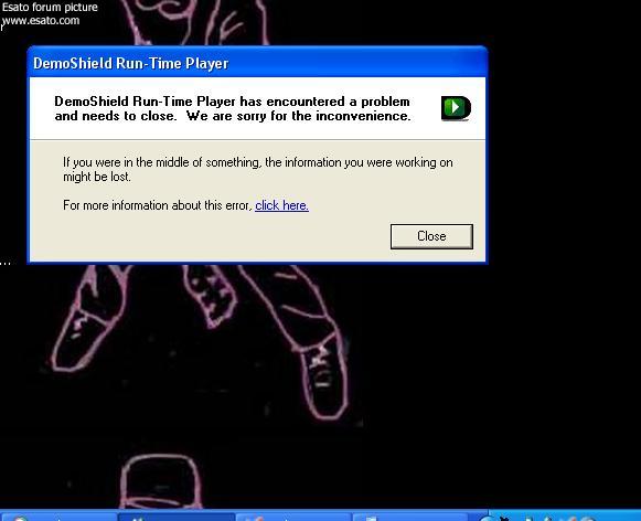

Maikka Joined: Jan 17, 2006 Posts: 1 PM, WWW
Mines does this x|
http://www.esato.com/board/ui/2uyvly4UiM3Vf28Yp98D.jpg
So, can someone help?
