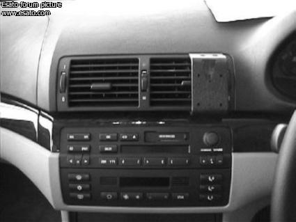

hijacking this thread (sorry!) ... what is the best way of fitting a p910i to a car without using screws or damaging the car, for use with sat nav... i.e. a need to see the screen?
i have a bmw 316ti compact

On the 3 Series I usually remove the stereo, then make up a bracket out of Aircraft Grade Aluminium, which is mounted to the left of the stereo (RHD), angled towards the driver and secured in place by one of the Philips screws which secures the stereo.
To this you can mount the HCH-37.
The bracket can be spray painted matte-black or have upholstery material glued to it.

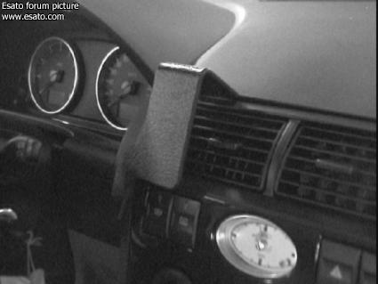

Try http://www.brodit.com :
[ This Message was edited by: Eepo on 2005-07-26 22:24 ]

Eepo
Joined: Nov 27, 2003
Posts: 70
Posted: 2005-07-27 07:30
On 2005-07-25 21:36:24, leocyber wrote:
Is there any car holder for ford Mondeo( > 2K model) to screw in the SEricsson car holder HCH37?
Any Idea is wellcome
Brodit has this idea:

@eepo
Those brodit brackets look very good.
Unfortunately, they're not available here in NZ that I know of.
They mount the cradle in front of the air vents though which is not ideal.
@leocyber
If you decide to go for that brodit bracket for the Mondeo, PM me and I will let you know how to remove the central dash panel to fit the bracket. There are some tricks involved and hidden screws to find.
I can save you some time and frustration...
@gyre
That photo of the 3 Series dash shows the bracket mounted over the air vent which I always try to avoid. It does have the advantage of placing the phone closer to you though. Here's where I'd mount my bracket:
