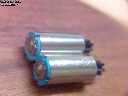

The two motors. On the right the original Car100 motor, on the left the new 42000rpm motor. Note the terminal on the base of the car100 motor is deeper than the terminal of the new motor. This means the car100 engine bay needs to be modified for bitcharg and zipzap motors:
The engine bay can be easily modified by bending the base terminal connector in slightly towards the centre of the engine bay:
New motor in place:
Snug as a bug in a rug:

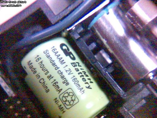

Next thing on the agenda is to find a longer lasting battery:
