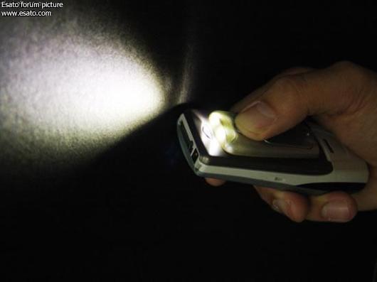

Goodbye Bluetorch, meet:
It's powered by a single LUXEON emitter. Very bright!

If i could hazzard a guess i'd say the connector is an OEM charger port, and where the light emits was where the cable was. If its home made, can u supply us with schematics/plans?

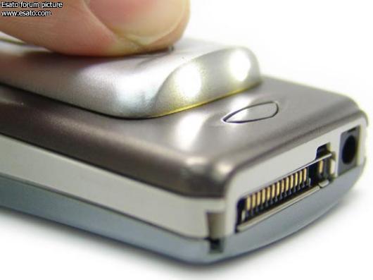

On 2005-05-02 10:44:00, Avatar235 wrote:
Looks nice!
Very keen! Yep I salvaged the connector from a car charger.
The LED is made by LUXEON (www.luxeon.com). These are the brightest LEDs you can find. Much much brighter than traditional "super bright" LEDs.
I simply used a 10ohm resistor for current limiting. Due to size constraints I couldn't use a large heatsink which would've allowed the higher currents for much brighter light. For thermal management I used an L-shaped aluminum with one side epoxy bonded to the plastic housing and the other thermally attached to the luxeon's back slug via Thermagon T-grease 2500 (thermal grease). The plastic housing does heat up a bit when used continuously.
I also attached a collimator lens to focus the beam:
It's \\ NOT /// !!! Look at it sideways !

Here's the comparison with a penlight incandescent bulb flashlight (left) and my luxeon attachment (right):
The luxeon is so bright it makes the text unreadable...

Very safe. It only draws about 80mA from your phone.
