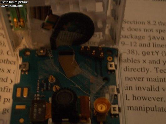

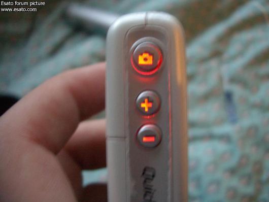

The final mod which i completed (for now lets say) is my favourite, using an LED from an iPod, i opened up my phone and wired the LED up so that it would flash when the vibrator worked. I Then stuck the LED under the volume buttons.
THE RESULT IS PERFECT. one LED is enough to light both the + and - buttons up (i plan to put another LED under the cam button but will leave that for another rainy day).
The LED mod took the longest, about 2 hours in all, the wires i used are so small. Ive posted some pic of the exterior, none of the interior since when i open my phone now im at risk of destroying all my work.

how about some pics of the LED's in action ?

yeh, the uploading didnt work, but theres a link to a shot of the LED in action.
i think it will be easier to add a secod LED under the cam button, the only trouble is there a bugger to solder (so small)
plus getting the wires to avoid each other took a lot of effort, i thought i had done it only to find they prevented the speaker working.
took about half an hour to put together in all, however i can just add LEDs in paralle with the initial one hopefully.

@greg, yup that looks good. AWESOME even hey use, wax to avoid the wires touching. can you post a pic when you open up the phone? because i wud very much like to know how you did that.

avoiding the wires touching was the hardest, i used thick clear sellotape. Took the phone apart again, but its a bitch to manouver as the wires are tight, i have second LED ready to install but connecting the wires togther seems a little tricky , but i really wanna get it full working and be more happy.

Right, just finsihed installing the second LED, boy are things good now.
It took all the time in the world, for a while my keypad froze, i had to cut a bit off my housing.
but i did it!!!
i now have 2 LEDs connected in parallel with vibrator 1 lighting up the + and - buttons another for the cam button.
results are PERFECT.
uploaded more pics and another vid
