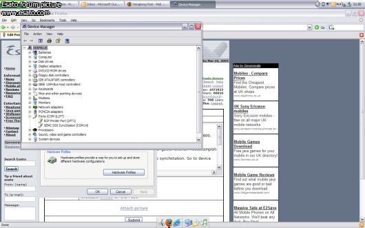

Here are my suggestions to solve your problem:
Firstly uninstall any software supplied with both your k700i and P800.
Then go here:
http://www.sonyericsson.com/s[....]1&pid=10161&fid=11349&esi=true
and download these latest drivers for the synchstation. Go to device manager in WinXP and look under Ports as shown in the pic below:
Once you have done that, download the latest PC suite for the k700i here:
http://www.sonyericsson.com/s[....]_1&pid=10139&fid=6995&esi=true
Give this a try then cme back and let us know what happens.
Hope this makes sense.
