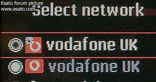

Today i noticed i was getting the message in the subject instead of vodafone UK.

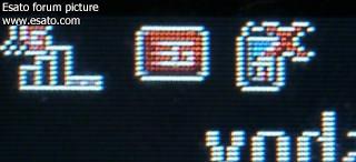

I have gone to manual network selection and then select network. There are two options for vodafone. One has a small blue "cross" in the top left corner of the voda logo. This one pops up the 3G icon & Gprs icon and signal strength but i now also get a small phone with a red cross through the upper right portion.
The second vodafone option which does not have the blue cross seems fine but i am assuming that is a 2G only network selection.

Have you had the phone since launch? are you in a 3G or 2G service area? I have the problem right now with 4 bars of 2G service, but my suspicion is the very weak 3G signal nearby is interfering with it somehow. I cannot make or receive calls and just hear 3 beeps when I try, and after a while either "no access to network" or a phone with a red cross over it is displayed.

I then unlocked the SIM lock on my phone.. and since then, it's been having network issues (especially outside of Japan). When outside of Japan, I VERY often receive the 'No Network Access' message, and also the picture of the phone with the red cross on it. I also find that if I turn my phone off and on, it'll sometimes connect to the network, and then drop out after a short while.
