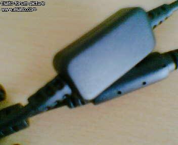

its most likely you have the data cable, does it has a little box thingy on the wire like this:
If it dont you have a data cable and it wont work.

hmz no i dont have a box thing on my cable.. Just a serial com on 1 side and the other side has a SE connector. Nothing between it.
Strange that this hasnt been mentioned? Anyone that has a service cable WITHOUT the box thing in the middle?

jagger2k
Joined: Nov 14, 2004
From: Leicester, UK Phone: IPh
Posted: 2005-02-23 17:34
Service cable HAS!! the black box on it.
Data Cable does NOT have the black box.
[ This Message was edited by: jagger2k on 2005-02-23 16:36 ]

jagger2k
Posted: 2005-02-23 17:42
the one for flashing, unlocking, debranding is the Service cable (the one with the black box)
The other is to transfer stuff to and from the phone.

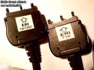

The one on the left is service cable. One on the right is data. Other than the labels, they look identical on the outside. I have these cables and have used them for the intended purposes. There is no small box thingy on either of them.
[ This Message was edited by: ESTOR on 2005-02-23 23:20 ]
