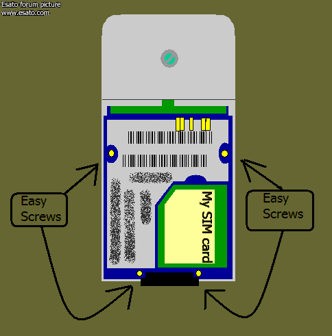

There are 6 screw you need to remove.
(1) Remove the back battery panel
(2) There are 4 screws in plain sight - unscrew them.

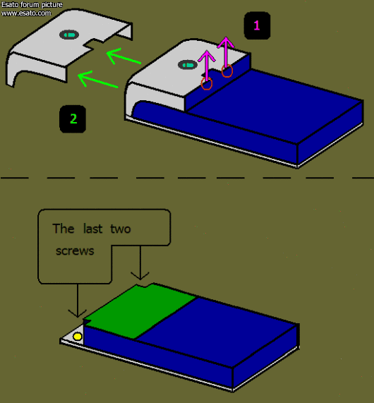

(3) Use a FlatHead screwdriver (or something similar) for this step. Place the phone face-down on a table (so your SIM card is facing you). See the 5 battery terminal contacts? Just above those contacts, there is a "notch" in the silver plastic. Using the screwdriver, you need to raise the silver plastic (where the notch is) about 1-2mm (that's about 1/16th of an inch in the old scale), and then slide that silver plastic back and off the case.
(4) Unscrew the last 2 screws that you can see now.
See, it's pretty simple once you know the trick, but I imagine a few people have almost snapped their PCBs not realising there were still 2 hidden screws.

Thanks for this....but I dont understand point 3), could you write it once more please? |

Sorry for bumping this month-old thread, but, like Hmyzak_SE, I am having a problem with the little notch in step 3. I have a T237, but from reading around on these forums, I believe it should be physically the same.
I have located the notch on my phone, but I can't seem to lift up the back cover to slide it back. I am having a problem with a few stuck keys. |
