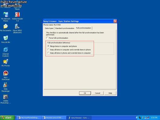

Sounds to me like you don't have the conflict-resolution settings right in sync station. I sync with outlook no problem.

I sync via bt. Conflict resolution should not be a problem because I am adding new items on the phone that are not in Outlook. Still I tried all the options with no avail.
The bt connectivity works, I can sync all my contacts from Outlook to the phone but not back.

fu1at Joined: Nov 01, 2003 Posts: 325 From: Selangor, Malaysia PM |
i believe the problem happen here
