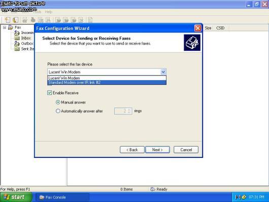

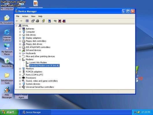

fu1at Joined: Nov 01, 2003 Posts: 325 From: Selangor, Malaysia PM |
there's is a IrDa modem driver download at official site. try to download and install it.
once u had installed it, turn on your IrDa on K700i and direct face it to your pc/notebook IrDa port.
Immediately your pc/notebook will will capture the IrDa modem on your COM port.
by then run your pc/notebook fax software. try to select your fax modem from your fax software and choose the K700i IrDa modem as your fax modem.
it's kinda complicated. u have to connect your K700i and link it with your pc/notebook before u can run your fax software.
not only that, u have to make a manual set your modem to K700i everytime u wanted to use it.
this is because the moment the IrDa or bluetooth modem didn't connect to any of your COM port. the setting will be gone and u have to manually set it back again.
i hope the above explaination could help u.
cheers
p/s if u still can't i will try to organize some picture to assist u. by the way.... windows XP sp2 have built in fax option allow u to fax out anything u want by not using third party software.
my notebook Device Manager
my windows fax setting
 J200, W550i, K750i, M600i, HBH-30, HBH-660, HBH-608, HBH-PV700, HBH-610, MXE-60, CLA-60, MMC-60, CDS-60, |
