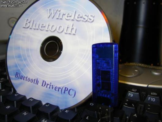

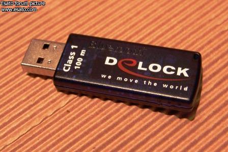

USB Bluetooth Class 1
(Product no: 61287)
(I’ve originally written this review for the Norwegian site http://www.carputer.no but though it would be of some relevance to members of Esato as well.)
The latest in Bluetooth, for private use, is class 1. With it’s radius of 100 metres it gives us an opportunity to take advantage of the features more easily and the danger of loosing the connection is dramatically reduced compared to the 10 metres Bluetooth dongles. A person blocking the “view” is often all it takes. Class 1 eliminates this in the areas most people will choose to use a Bluetooth dongle.
Expectations were high when the package was opened up and this little blue device was lying on the table in front of me. “100 metres is nothing to joke about!” I thought and inserted the CD and installed the software.
The disappointment was, if possible, even higher when everything was installed and looked ready for my first test of the unit; “Radio Licence Certificate Missing”???!!!
Since the dongle was sent directly from Germany my first thought was that German law required a special licence to be able to use a Bluetooth unit with a range of 100 metres. A quick phone call to DeLock in Germany proved my worries wrong; “Hast du Service Pack zwei innstaliert?” Aber doch!!! Problem solved; a separate file on the CD had to be opened and activated for SP2. All my radio-communication-licence-worries were history!
To check that this actually was a “Plug and Play”-unit, as promised on the box, I installed the DeLink on a PC without SP2; the box was right! Straight in, SMACK! up and running!
