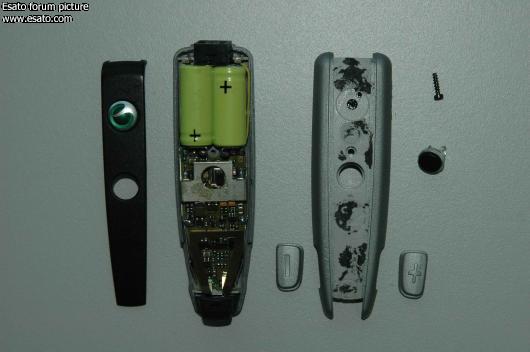

Anybody knows where I can get replacement batteries for HBH-60 other than from Sony Ericsson Service Centre?
Thanks.

Do you know the voltage of it? See if you can find cordless phone batteries of same size and voltage.

you can't even sonyericsson sevice centers don't have . if something sould happen to it during the warranty period the replace them. it has appened to me 3 times with my hbh-60 they sent me an hbh-65 and that went dead after 3 months and now the sent me a hbh-600 (!)

There is no voltage indication on the battery. I also does not indicate the type of rechargable battery. Digital Voltmeter reading indicates 1.263v per cell, 2.516v with 2 cells combined.
The solder joint is not really good, and comes of rather easily. A hard impact may cause the solder joint to o/c, and thus giving intermittent problems. However, I am still looking around for replacements.
Sonyericcson service centre does not carry any parts for it. What a shame.
