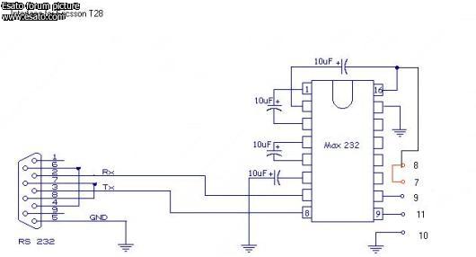

I want to create MY sony-ericsson cable |
Slash Joined: Oct 18, 2004 Posts: 11 PM |
It's possible to find me cable connection to create MY sony-ericsson cable
USB cable or COM cable
THANKS  |

rekan Joined: Oct 22, 2004 Posts: 5 From: Sweden PM |
check mobile.box.sk and look for t28 cable, I made one today with information on this board.
look on the connector to the phone. it looks like
|12345678|9|1011|
take away pin 4, 5 ,6 and 7
then change the wire 4->7
5->7
and put an connection between 9 and 11 |
5->7
I not understand this change ?? pls can rexplain me or re-attache pic with the right connection
this cable work with all sony ericsson phones for download and upload operation ?? where is the soft to use with this cable ??
thanks
sorry for to poor information. i made an unlock cable from an data cable i got cheap from the store. i changed the pin , 4->6 and 5->7
unlock cable uses pin 6 and 7 and an datacable for sending pictures/music etc uses pin 4 and 5
excuse my inorance, but I wahnt to echange music and image (data) betowen my T230 and other sony-ericsson phones
what cable I create ? your cable can go this ??
In the two pic the pin 4 and 5 are not in use ??
thanks for all |
ESTOR Joined: Apr 20, 2002 Posts: > 500 From: Singapore PM |
You need a data cable. But with T230, you can only send pictures, ringtons etc. TO the phone, not from phone to PC. And it's easier to just buy a no-name data cable. I don't think you can buy 1 chip needed for the cable for cheap anywhere. |
