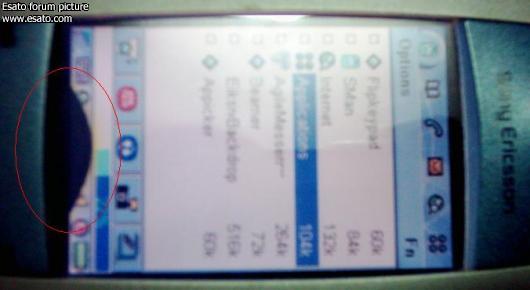

It is not any stain or something like that and i do not have any SE service centre nearby. i am attaching a image of phone now please check.

WOW! thats huge...looks like maybe it was pressed too hard against something and the screen almost "bleed" in that area...
if its still under warrenty i would send it back...otherwise get a new screen
BTW...thats not just a few dead pixals...thats a lot...100+ im guessing

I can't see the pic at the moment but if it is the same situation as in another recent thread then it is dead & needs a new screen.
The other one & my cousins P800 developed a big black semi-circle at the bottom after being dropped. Although the touch sense still works the display is black even when off.
My best guess is that the screen has been damaged & the liquid crystal in the screen has leaked & pooled there. You cannot take the screen apart as they are a sealed unit but u can get a new one for £50-60
the picture shows exactly that

I agree with Mik - looks like screen damage! Have you dropped/sat on/leant on the phone at all recently? It's certainly a new screen job unless you can live with the big blob.
