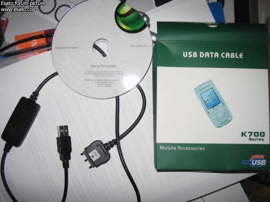

I just bought a generic USB cable (USB Data Cable, K700 Series) and i can't get it to detect my t230.

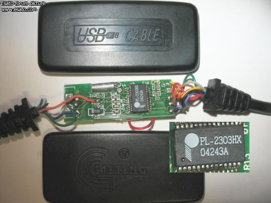

I FIXED THE PROBLEM!
I opened up the box on the cable and found the chip version was pl-2303HX. got the drivers for it and that didnt work. At this stage i was desparate, and i found on the Prolific site an EEPROM writer, so i tried changing the PID to 2303 from its original 1234. didnt work. then i accidentaly hit the "writer default" button. it went through and changed a bunch of the eeprom settings and now it works perfectly! I didnt bloody beleive it. Anyway, if anyone with the same problem wants to give it a shot, here is the eeprom writer:
http://tech.prolific.com.tw/visitor/fcabdl.asp?fid=30641423
Picture of the chip:
