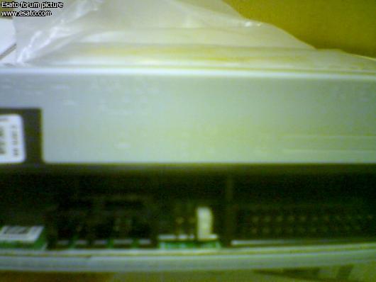

I'd Secondary Master the Pioneer DVD, this requires you to take the side off your PC and move a jumper (white plastic covered metal in the pic from SL to MA) at the rear of DVD drive next to the IDE ribbon. Apologies for the bad pic but enought to give you an idea.
PS Pin description is usually stamped into the metal as
C M S
S A L
haynesycop

Joined: Mar 10, 2004
Posted: 2004-08-20 17:54
thatnks for the response, i tried opening it up yesterday - tiny certainly dont like you messing with there pc's its a bugger to get into lol
i will try your suggestion, hopefully it will work
thanks so much for you help
