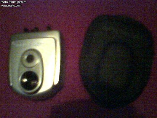

Secondly, the phone came with a small attachable camera:
Next question - what's the model number of it? Is it an MCA-10, 20, 25, or 30? Or none of the above? Ta very much!

Just found out that the camera is most probably an MCA-25.

Yes, the MCA-25 will work with T86i.

but if the mca 25 is used with the t68i it wont have zoom

I didn't see the pic on PDA. Now I can see it, and it's the MCA-25.
