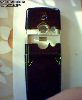

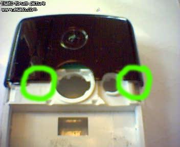

Hi guys.. Since the server with the pics to the first guide on how to take the t610 apart crashed, I made a new one.. hope it's good... !!! USE THIS GUIDE ON YOUR OWN RISK. I'M NOT RESPONSIBLE FOR ANY DAMAGED PHONES!!!
1: Remove the battery cover
2: Lift here and here with your fingernails or something that's made out of hard plast.... I don't use metal things because I don't wanna damage the cover:
3: Push the cover away from you:

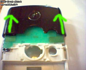

4: Lift up here carefully till you hear a little click and then simply remove the green part ( antenna), but be careful

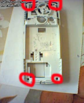

5: Remove the 4 torx screws.. For this you'll need an T6 screwdriver:

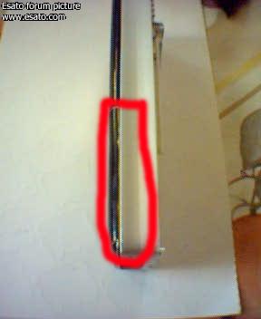

6: Now use your fingernails or a thin plastic thing and slide it in between the cover and the white part.. Move it all the way up untill the cover goes off.. Be careful and don't stick it to far inside. When the cover is off on one side just take it carefully of:

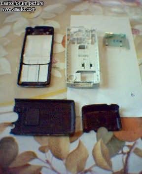

7: There you go...: The T610 is now taken apart... Just reverse the whole process to assemble it again... Hope this helped, and excuse the bad quality of the pics

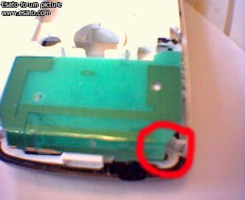

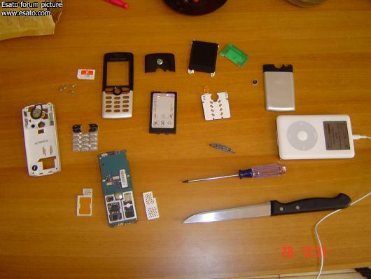

here a little addition to the thread.
I did this on my one month holiday to italy, I had done it loads of times before, but sadly this time the microphone died so i had to get a new k700 .
Sorry about the size of the picture
Could somebody please confirm that the little rubber thing next to where the sim card goes, on the "skeleton" (white piece) of the phone, is actually the microphone.

@folling182 , the mic is in the left bottom , the round rubber thingy like you said

Wow thanks! My mic was f*cked up. The inside was really dusty and after some blowing en pushing with a screwdriver I managed to get rid of most of the dust. Think the dust got between the mic and the two circles thing, so the signal was bad. Now I'm back up!

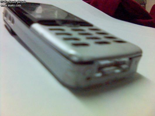

here's my t610
after high speed encounter with a wall (insides working in a new case)
