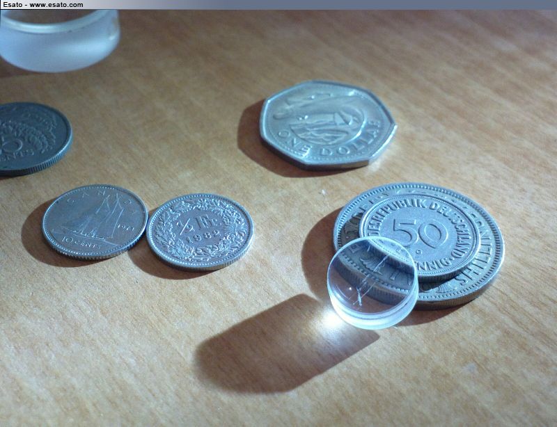

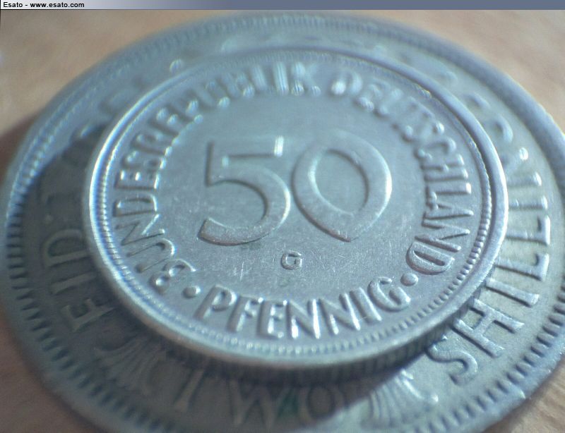

WooHoo.... found just the right element....
The little lens in that picture is something I have had sitting around for quite some time. I decided to hold it directly in front of the 808 lens and it worked exactly as I was hoping. Seems that the magnification was increased by about 10 and depth of field dramatically reduced. There was no one home today for eyeball pictures so I used some coins I had in a drawer....
.... depth of field SO SHALLOW that not even half the coin is in focus. I need to get out side and play with this combo a bit.

That's it...
By the looks of it ... might be shallower than the one used for the eye photograph in question.
