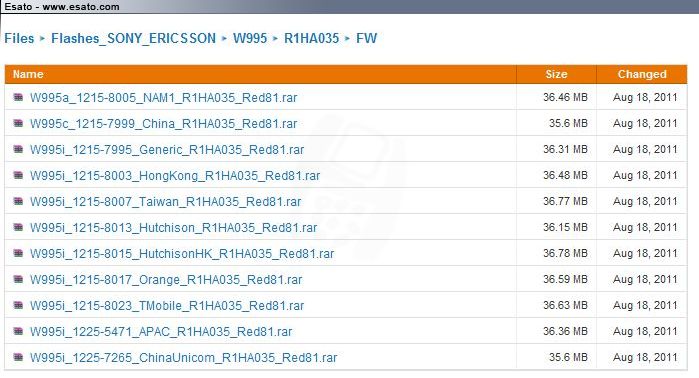

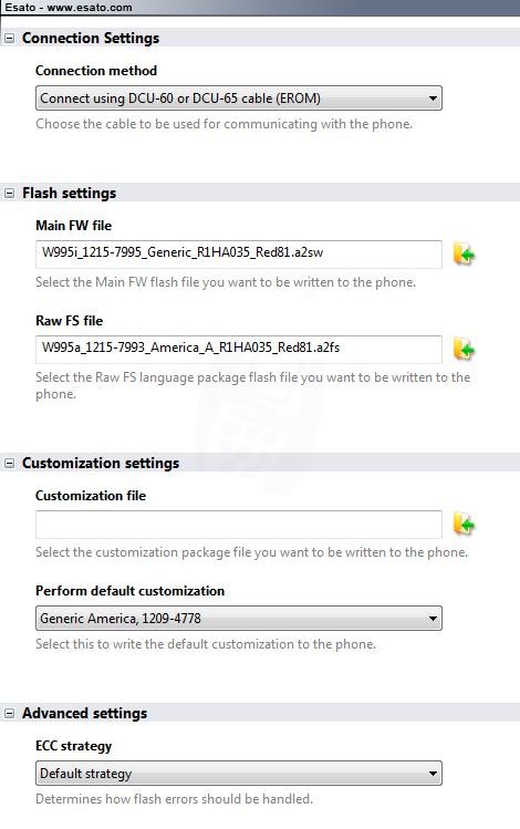

OK I will flash with one of those. I wasn't sure about the 'a'. Flashing like that is EASY with Omnius. However I don't even understand how you browse system folders. For example I downloaded a bunch of music skins. How do I navigate to and place them in tpa/system/multimedia/mp? I was able to use the A2 uploader to view this folder. but... I tried to drag the music skin folders into it and it wouldn't.
I also want to tweak settings. Anyways, I'll flash as you said first then come back with more questions. Thanks. Will try the U.S. version, close to Canada. |
junkaholic Joined: Jul 20, 2012 Posts: 7 PM |
Emporium, I apologize for being an idiot. I really want to use my phone but I feel completely stupid here so I'll start from beginning:
- My phones current software: 1215-7995 R1HA035 091210 SonyEricsson.
I go to Omnius here and there are no files that you have listed.
If this where I have to start, where do I get the files you have listed?
I used Omnius per this:
I still can't use SEUS after this firmware update; it still says "phone has been modified, can't be updated".
