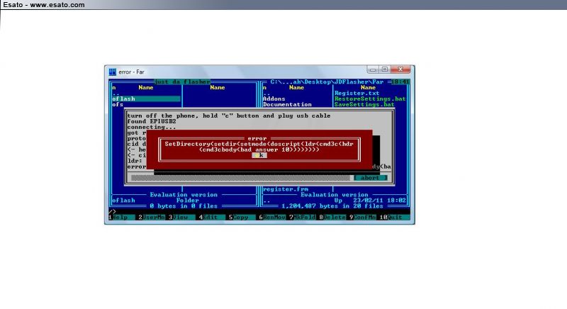

Hi can someone help me plz, My phone doesn't turn on but the infrared flashes when i press the power button & also when i plug my charger in the red light stays on for about 10mins then goes off, I have a K800i with CID53. I Have tried using JDFlasher + Far with any cid. I followed this guide on how to do it:
http://www.akshayy.com/sonyer[....]patching-tutorialguide-db2020/
Every time i try to open oflash i get an error which i have uploaded,
Also the same error when i press the ofs.
This is my log:

Maybe im not using the right files but i just want my phone to turn back on, I am very noob in this department so if anyone could please point me in the right direction and give me a detailed tutorial on how to do it including the files i need i would very much appreciate it thank you.
