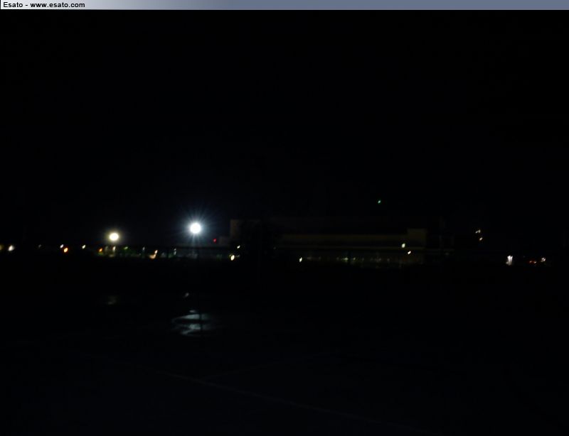

This one is taken from Elm (from Esato photo gallery) and adjusted levels

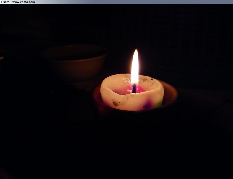

This one is taken from C901 (from Esato photo gallery) and adjusted levels
even C901 photos has very faint lines.

yes. if it hardware fault, every photos must contain these lines. it may be firmware bug that convert noise into blue line.
such lines can be seen in K750's viewfinder display while taking photos in low light condition. but its no visible as elm's since K750i has no noise reduction. |

most of SE phones produce these lines but they invisible to human eye. to see such lines, you have to adjust contrast, brightness, gamma etc..
I think it's an issue with the sensor so can't be fixed
