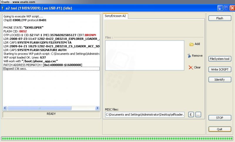

I've a patched C905 R1FA035 with many applied patches.
Now I want to apply ELF Pack to my 905, but when I tried to apply
elfloader.vkp, via A2 Uploader. It gives some sort of address error. Few other
patches are also showing this error...
I've captured the screen & attaching here. Somebody plz tell me why is it happening?
NOTE:
I also tried to patch elfloader.vkp to Un-patched phone_app.cxc but result
is the same.
[img] [/img]

My first question to you is that why do you use the older version of a2 when version of dt.22/09 is already there.
Coming back to your problem, i think applying patches directly via a2up is the most time consuming and boring procedure. You should use FAR patcher with denpo's plugins. It is fast and easy to apply many patches and elfs at a time.
What you should do is take fresh copy of your phone app.cxc and put patches with far method. Then upload that phone app.cxc via a2up. Thats it.

Remember one thing that you should always keep the copy of your phone_app.cxc in your pc and whenever you want to apply or remove any patch, you should use that fresh copy each time. That will eliminate many problem.
