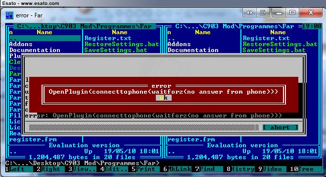

I've seen Brazzuka's Camera Drivers, and i've tried to install it. To do that i've search tutorials, of course i've found them. I've tried "Far", but after my phone is connected, i'm said that a problem occured and that it's not possible to connect my phone.
A picture is better than words :

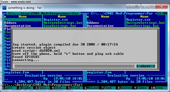

And after a few seconds :

A2 Uploader is the program you use to modify the C903, it's possible you have the wrong version or haven't installed the drivers that come with it.
Install A2 Uploader with GG setup
Install GG Setup
Open A2 Uploader
Turn phone off
Remove and re-insert battery
Make sure your phone's usb data cable is connected to your computer
Click "file system tool" button in A2 uploader
Hold C on your phone
Whilst holding the C key, connect the usb data cable to your phone
Keep holding C until the program loads a list on the right hand side of A2 Uploader
If you want to install camera driver go to ifs/settings/camera
Drag and drop camdriver0.dat (and/or camdriver1.dat) into that folder to replace your existing camera driver
When you are done click "shutdown FS manager"
If holding C doesn't work then hold keys 2 and 5 whilst connecting the cable to your phone.

Yeah ! Thanks a lot mriley
It seems the ggsetup I have installed was an old version. It's seems to works.
Thanks again for your very fast answer
