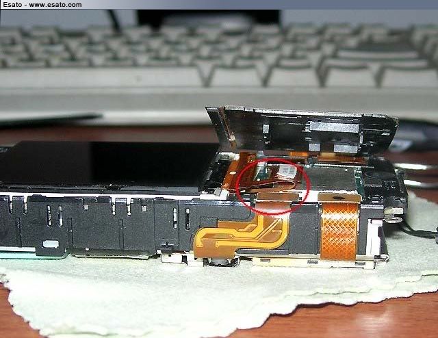

Cold Fusion
Joined: Nov 21, 2006
Posted: 2010-03-03 02:38
hey mate
i had the same prob with my k850 too. It's the LCD ribbon that runs under the keypad. If u press the a button on the keypad the LCD goes black, after a while when the keypad light is off, the LCD lights up again. I had my LCD replaced coz it didnt lit up anymore. Urs is still good so i think u wanna put something under the ribbon so it doesnt conflicts with other parts.

sincan
Xperia X8 White
Joined: Sep 06, 2008
Posts: 315
From: Surakarta Hadiningrat
Posted: 2010-03-03 17:49
after put cotton under ribbon,my lcd still blank. which part connected lcd with ribbon?

mallaccra
K850 Green
Joined: Oct 01, 2007
Posted: 2010-03-04 01:21
have a look here
